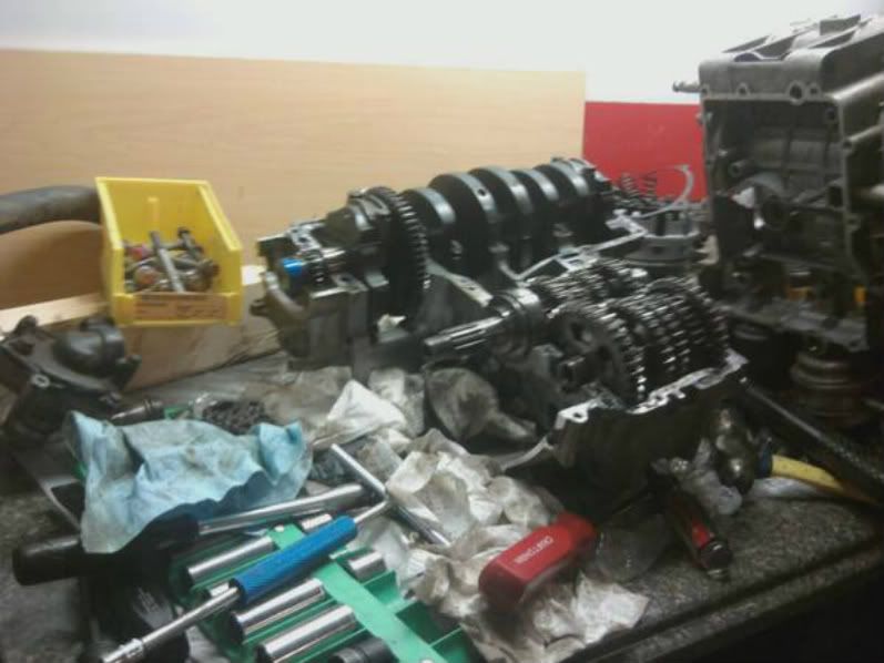

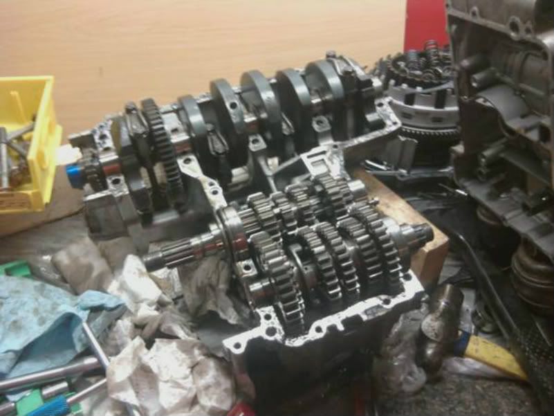

Discussion Starter · #9 · (Edited)
When I bought this engine I was assured by the seller that it was a good runner with no issues. I decided to tear it down as a peace of mind thing. I'm glad I did. After tear down I inspected all the parts to see what I needed. I found one serious problem that needed addressed. One of the transmission bearings was actually bent and causing some issues .
Apparently the pin that holds the cup for this bearing had slid into the casting. This allowed the cup to move outward from it's normal spot. When it moved the whole gearset moved. one of the transmission gears rubbed the case and caused the wear marks in the photo. The second photo shows how the cup(cap?) looked on the bearing when I pulled it apart. New bearing is on order. Should be here Monday. I plan to assemble the bottom end next weekend. In the mean time, I'm going to strip the cases,jug,head and all external engine covers to remove any surface corrosion and repaint everything. When it's done it will look like a new engine.
