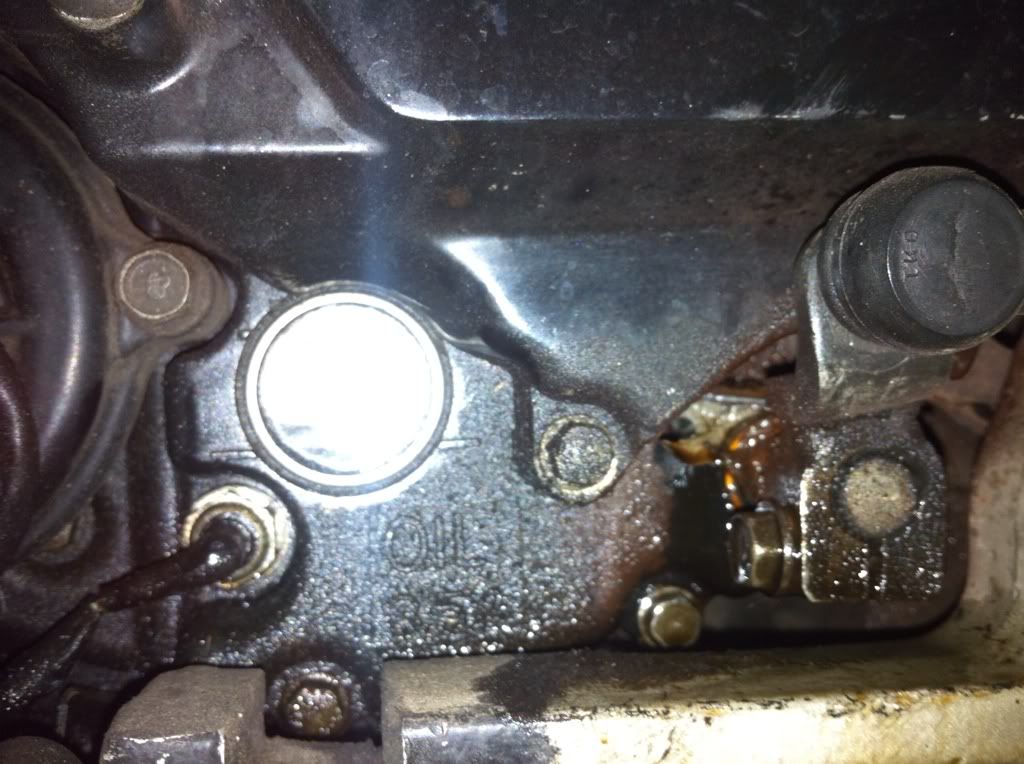

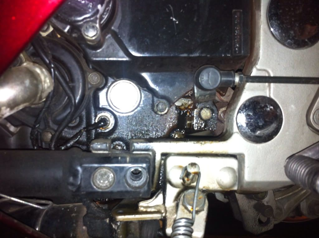

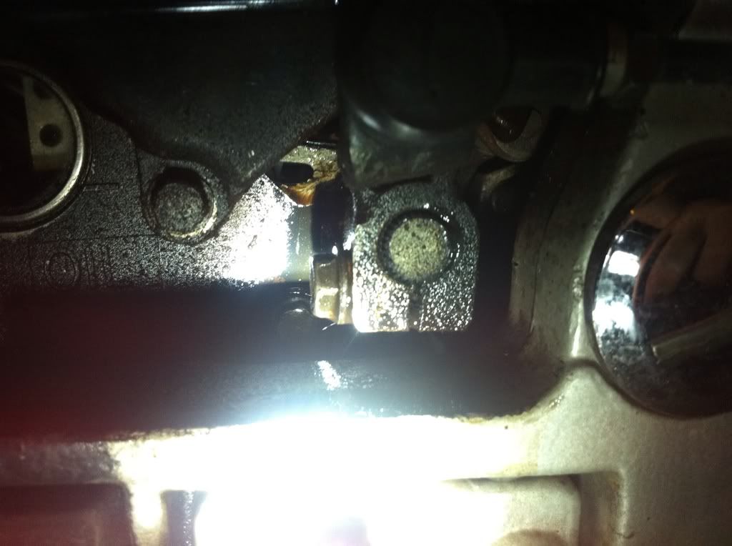

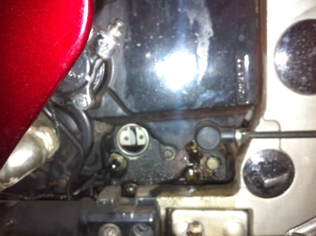

Well guys! Tragedy struck today after my ride home! I got home and noticed that my bike was sounding real funny! So I immediately checked the fluids! I noticed that oil was gone! I bought some to fill it up and see where it was going! After I put the bike on the kickstand the oil started shooting out of a hole! Looks like I managed to make a hole in the block! I believe this was due to the horrible POS chain that I had on the bike! It was constantly skipping and was incredibly loose! It looks like it was hacking away at the block! So I guess now I am going to have to buy a new crankcase! Unless I can just replace that part on the block which I doubt. Well anyways heres some pictures!

Hey Zx -Ninja,
I'm pretty sure you haven't trashed the crankcase.
It looks like you've broken the
engine cover under the chain cover.
It is replaceable and can be a PITA to do.
Here's some links to my posts about replacing said cover. If you need any help, feel free to ask.

13,207 Posts
A food lesson for the rest of us: Chains and sprockets should be replaced long before they start skippin' and jumpin' teeth. AS you can see by the pics above, it's false economy not to.

You could just have some leaky ass seals as well, but you won't know until you take the cover off.
If your chain hasn't come off, it's a pretty good bet that it's the seals and nothing major.
Although replacing those seals can be pain.
47 Posts
Discussion Starter · #10 ·
Hey Zx -Ninja,
http://www.zxforums.com/forums/zx-11-forum/53432-front-sprocket-covers-all-same.html
http://www.zxforums.com/forums/zx-11-forum/55668-now-installing-engine-cover-arrrrgh.html
Hope this is of help to ya.
Cheers,
Gav
PS here's a link to the cover, I just found on FEEBAY .
http://www.ebay.com.au/itm/TRANSMISSION-COVER-ZX1100C-ZX1100D-ZX11C-ZX11D-NINJA-90-94-91-92-93-SIDE-CASE-/140713030831?pt=Motorcycles_Parts_Accessories&hash=item20c32674af
Great!! I cant thank you enough!! You just took a load of stress off of myself!!
A very big lesson that I wont repeat!!
Yes, this window alone can be bought and replaced. I already made it on my engine.
I'm so glad to hear that!!!
