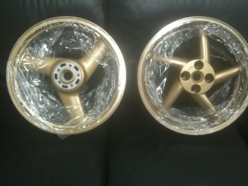

Got tired of seeing my zx7 sit and die... So I started gutting it and am doing a full rebuild, I'm replacing every gasket, cleaning carbs and powder coating some parts.. I just droped off my fairings for paint... I ended up changing my rear tail for a 06 r6 rear tail section.. I am in the process of moving the electronics and some stuff around and cleaning up the subframe.. I will post up some pics within the next week or so... For now here is a teaser...

I have since cut off the rear pass pegs, and relocated all electronics under seat so nothing is showing, and am in the process of polishing the subframe..
