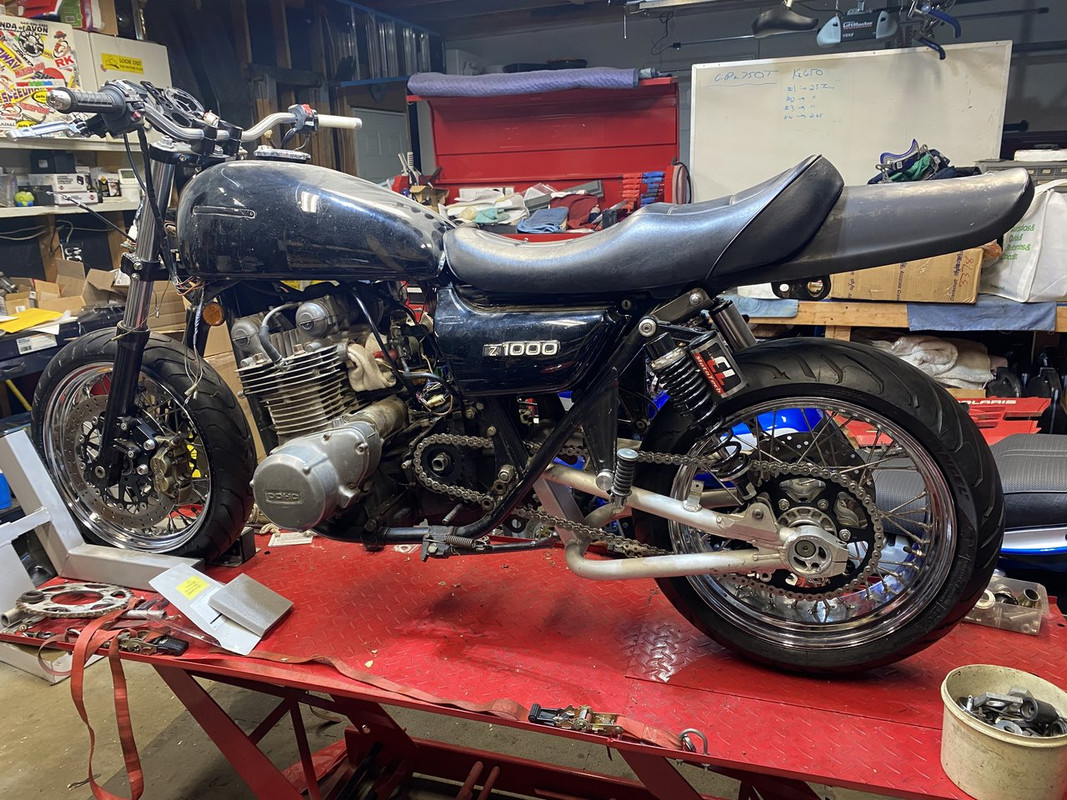

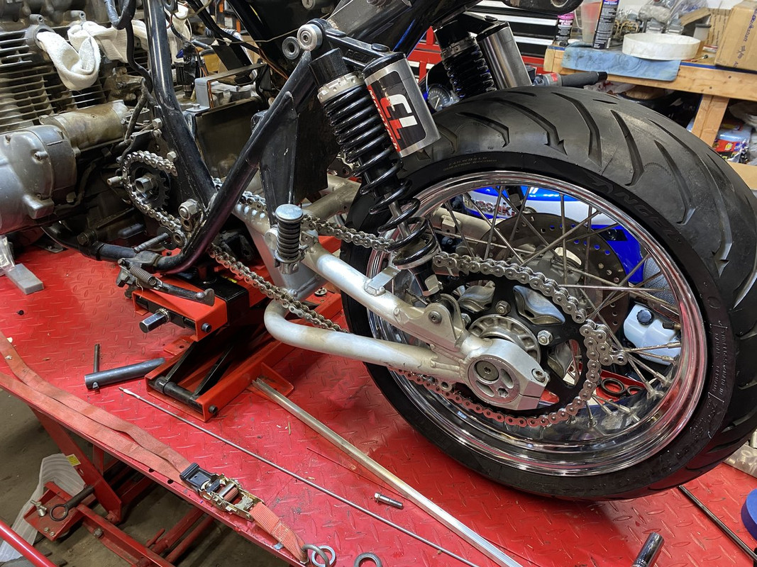

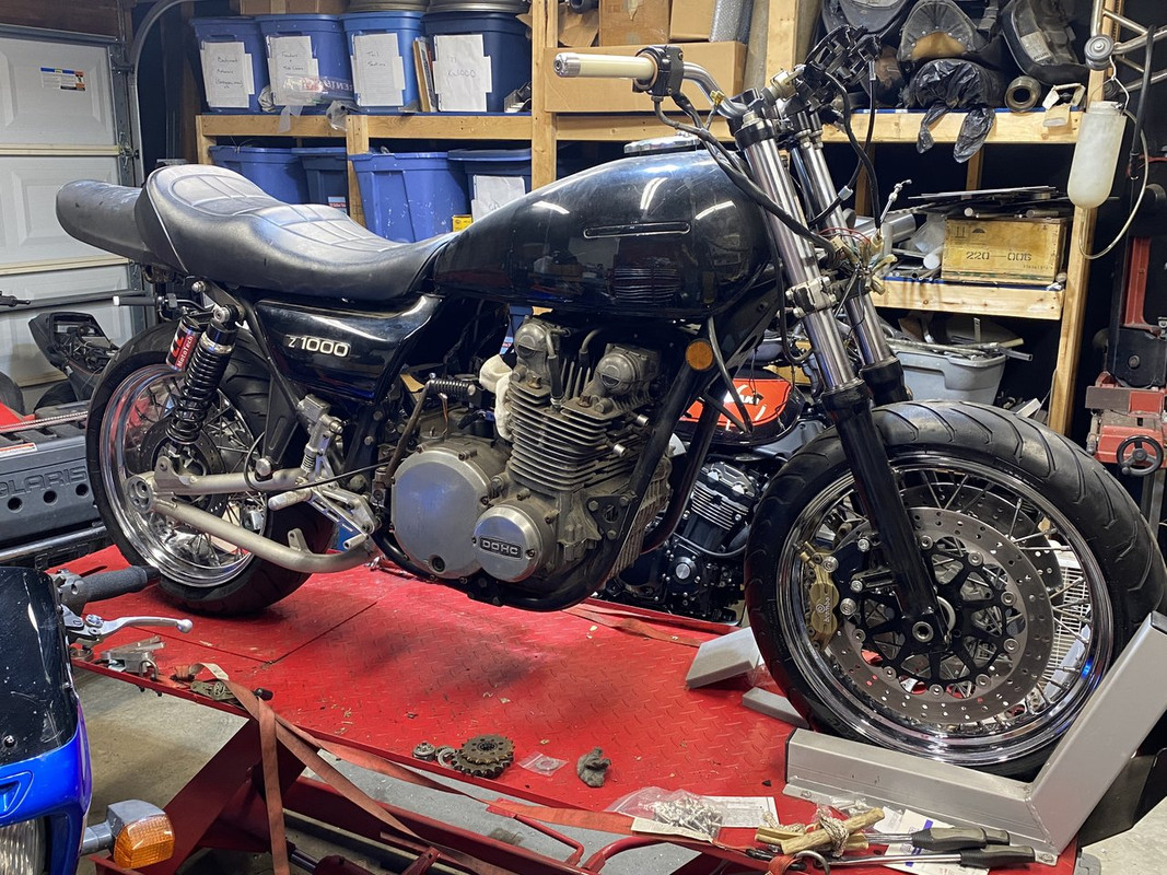

I highly doubt anything will just “bolt up”, but look at Ducati Sport Classic wheels. I swapped a set from a GT1000 onto my ‘78 Kz1000. I already had a set of ‘89-90 Zx7 forks and a Zrx1100 swingarm. Both Kawi pieces run a 20mm axle so I swapped the front bearings from the 25mm ID to 20mm ones. Unfortunately, I can’t remember if I messed with the rear wheel’s bearing. You probably won’t have to swap the fronts like I had to.
Later, Doug

That looks great, Doug! Thank you for sharing this information too!

Thats a very nice ZED
