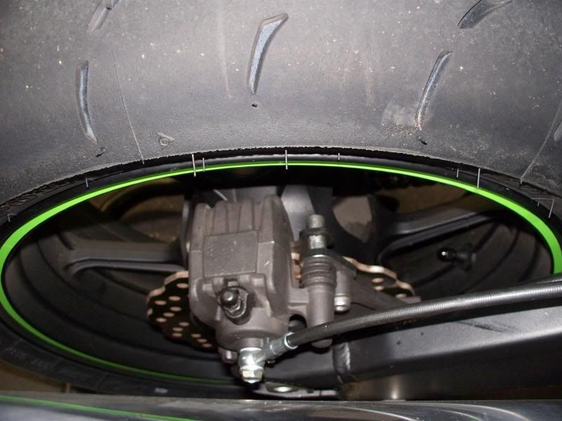

did you end up modifying the subframe?
Wheeeeeeeeeeeeeeew!
Turned out awesome, dude!
Beautiful work. That bike looks about 5 years younger. :crazyloco
Thanks, guys. :smile
just catching up and it looks great!:clap
Thank you.
No, I didn't, at least not yet. It may not need it. Once I installed those dog bones and raised the rear to an appropriate height I really gained quite a bit of clearance. On my first shake-down ride I tried to go over as many bumps and dips as possible so as to get the swing arm to bump the frame if it was going to and it never did.
It's hard to explain but the side of the swing arm is actually tapered at an angle. If it were to hit my sub frame, there on the right side where it's close, it would only do so about 1/4 way down the swing arm, so there's actually more room to move there than previously expected at a glance.
It's one of those things that I'm going to have to feel out. I should be taking her out for a better shake-down run today. Last time I just ran around my neighborhood for a bit. Today I'll try a few back roads and such. I'll report back.

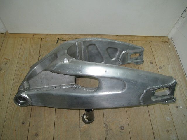

Do you think that this WSB kit swinger that I am being offered makes my rear end look to big?
See less See more
Yes.... so you should let me have it :p
No way! The 7r could use some rear end girth. That's why I wanted to swap swing arms in the first place (plus lighter weight, of course). The stock swing arm just looks too thin for a bike that's so beefy, imo.
Going out on a limb here; I'm guessing you paid slightly more for that than the $70 I paid for my Gen III 10r swing arm... Call it a hunch.

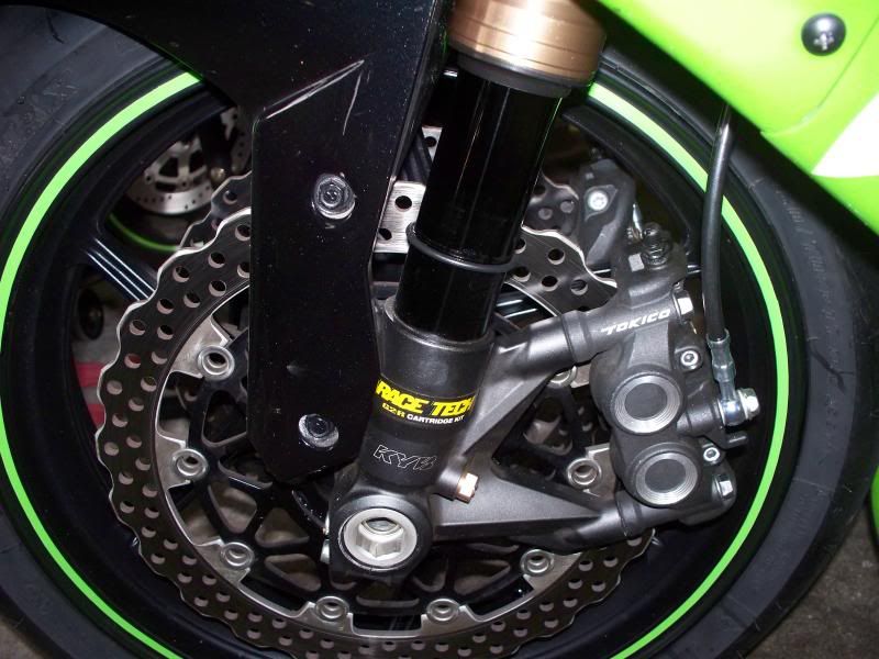

Just got back from my first decent ride on the bike since the front and rear suspension installation. Things went really well, so well that I extended the ride a bit. Didn't get too crazy with any cornering (fresh tires) but I tried to push the suspension and brakes by accelerating hard, braking hard, braking hard over bumps in the road (intersections), intentionally hit a few potholes and hard dips to check the swing arm clearance (no issues thus far).
This thing turns in much quicker now. I'm not used to it and I find it catches me by surprise. Very little input at the bars translates to a more immediate reaction by the bike that still seems foreign to me. I'm used to having to work a little harder with the stock suspension.
Most immediately noticeable differences:
- Braking/stopping power
- Front suspension smoothness
This things stops REALLY well with very little effort at the lever. The front suspension is very smooth without being too vague, feedback seemed good.
First impression on the rear suspension is that it doesn't seem to be leagues different than the stock 7r rear shock and suspension. The rear brake seems to have improved, not that that is really much of an issue anyway.
It will take some time and quite a few more rides for me to really be able to form a better impression, but I'm quite pleased with all of the changes so far.

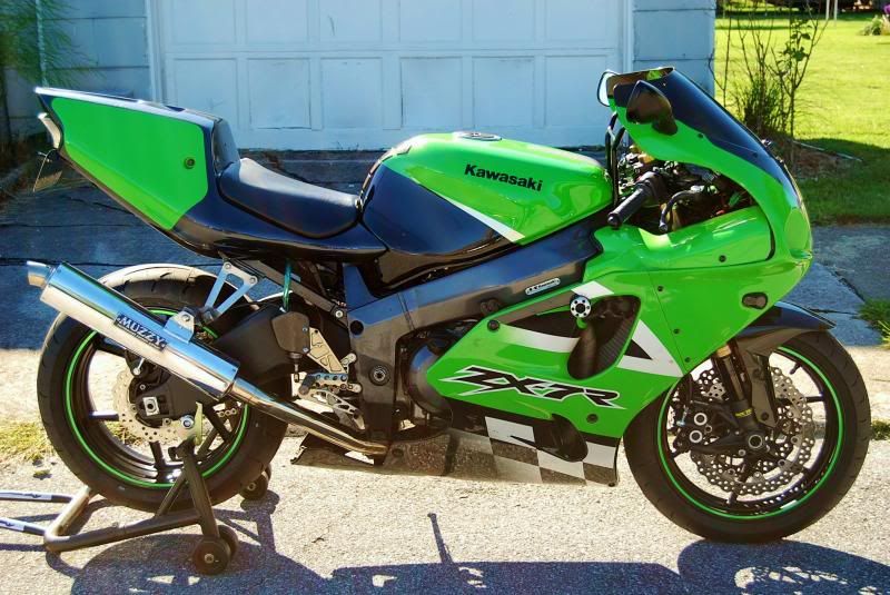

This past Friday was my gf's birthday so we decided to go riding. The weather was perfect, about 78 degrees and sunny.
Since the last ride went so well I decided to push the bike just a bit further to see if I could expose any weaknesses (what I would consider to be 70% pace, on the street anyway).
She handled really well. Now some of the things that were more subtle at slower speeds. Braking, entering corners, and initiating the turn are all much smoother now. Before, with the 7r front end, braking for a corner and initiating lean could be a bit sketchy.
Again, these brakes are amazing. Between the lower rotating mass, upgraded calipers/rotors, and suspension, the front end just applies stopping force to the front tire really well. I'm required to use very little force at the lever.
As for the rear swing arm clearance, still no problems or any signs of bottoming out, and I went over some large dips, bumps, and potholes at high speed... No problems.
A few pics post-ride:
Still have a bunch of fork left on the front end for emergency braking and more aggressive riding.
This is what I mean when I say 70%, about a half inch chicken strip left on the outside of the rear tire (hard to see it but the edge is just above the small Dunlop "D>"). Had to take it a little easy yet, this is still only my second ride on fresh tires.
