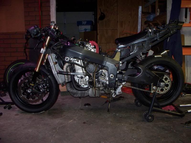

Chain is on and set to tension. Everything's tightened up. Forgot to mention that I picked up a chain guard on eBay, pictured here.
Front brakes are back on with the OEM brake caliper bolts I ordered. They were dragging a bit the other day, wasn't sure why so I pressed the pistons back into the caliper housing, bolted them up, and reseated the pads. They work fine now.
In my opinion, suspension and brake system is ready to go (at least for a test to see where we stand). In the next few days I'll probably throw at least the tank back on and take her for a spin around the block just to see what's up and go from there.
See less See more

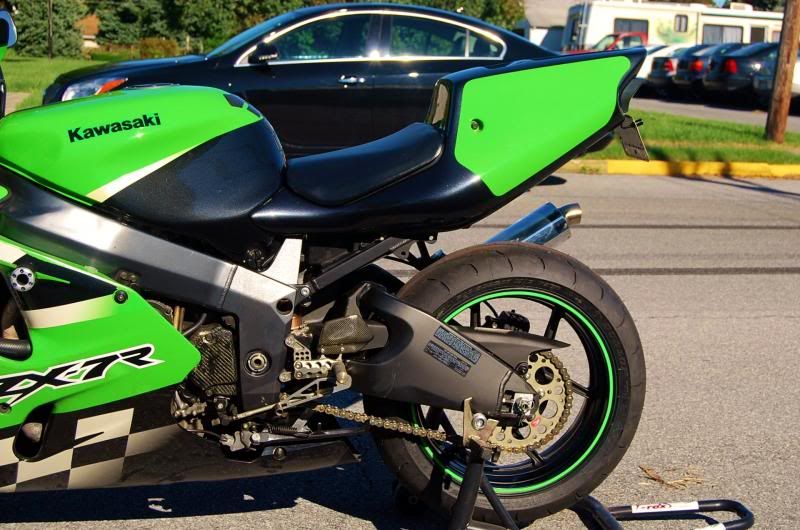

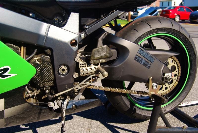

Bodywork is back on.
Took the time to set the front and rear rider sag (with the help of my lovely assistant). Both are set at approx. 35mm.
We took the time to weigh the bike. I forgot my sheet with my initial zx7r overall weight, so I don't have that for comparison but today she weighed in at 460 lbs. with half a tank of fuel.
With myself seated in riding position on the bike my scales read 310lbs for the front and 320lbs for the rear, so I've got a reasonably even weight distribution.
After that, went out for a short shake-down run around the neighborhood. She feels different but good. I honestly couldn't enjoy it, I was too busy paying attention to the drive train and brakes, making sure everything was working correctly (no weird vibrations, noises, disturbances, etc.).
I found a few odds and ends to tidy up. I still need to put my Dynabeads in the tires. Bike needs wiped down. I'd like to put my wheel stripes on as well.
Hope to have some nice pics for you guys soon.
:cheers
See less See more

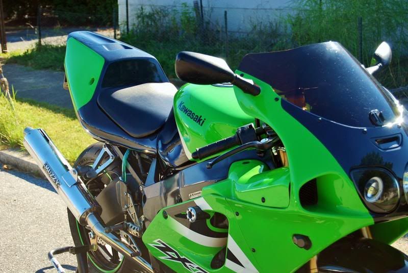

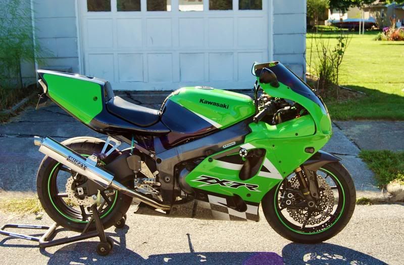

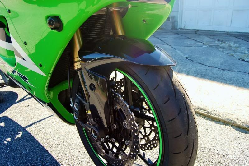

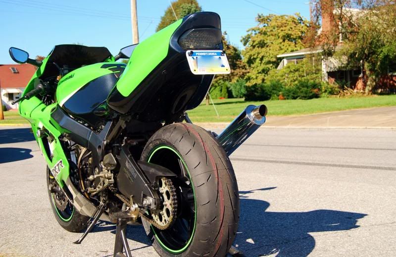

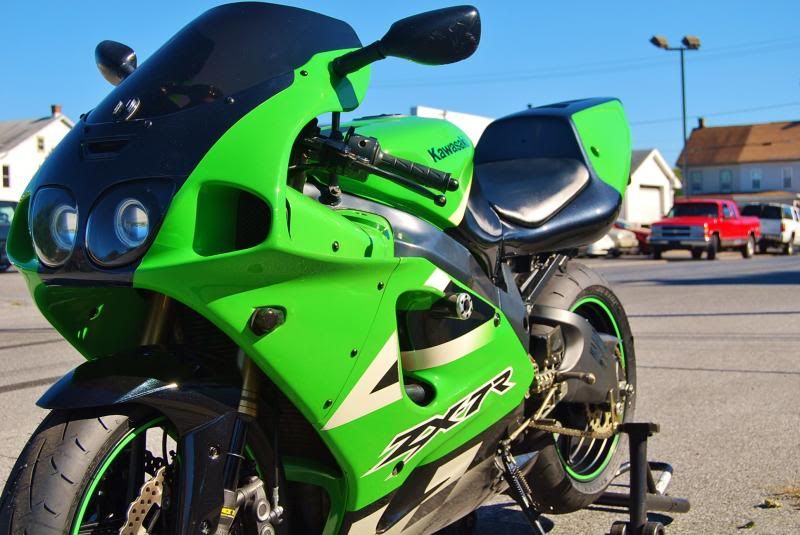

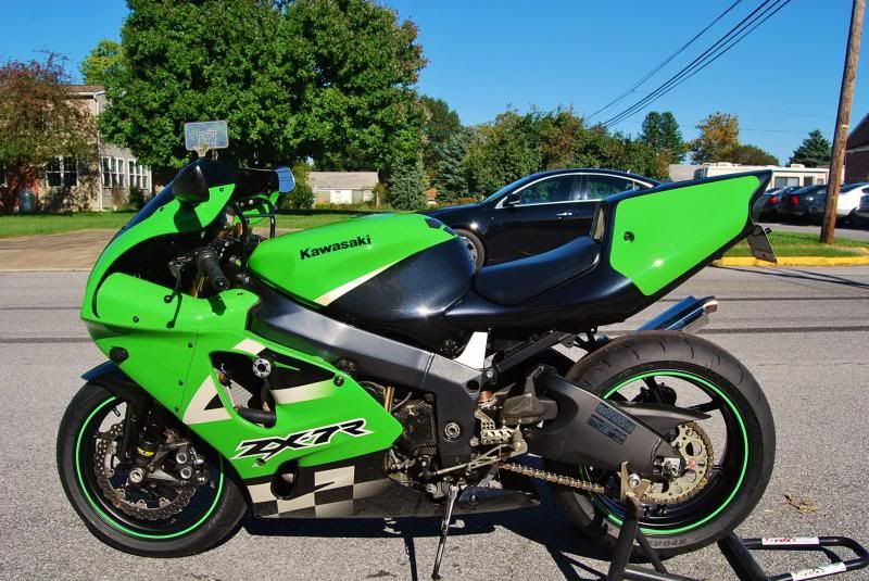

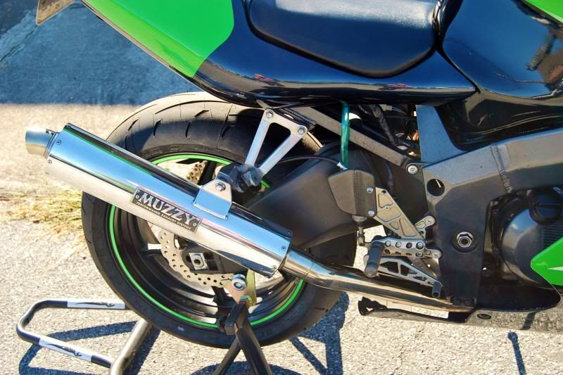

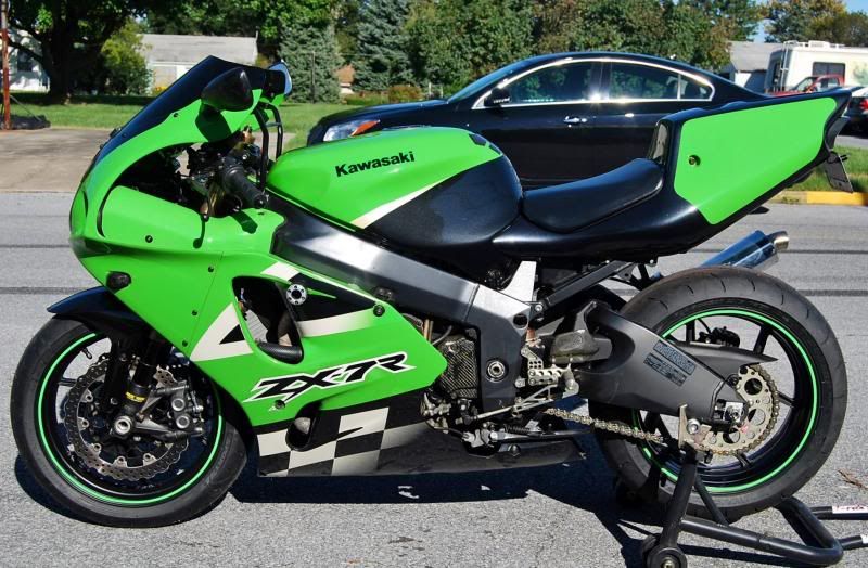

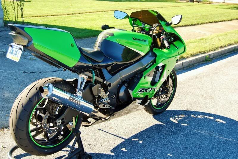

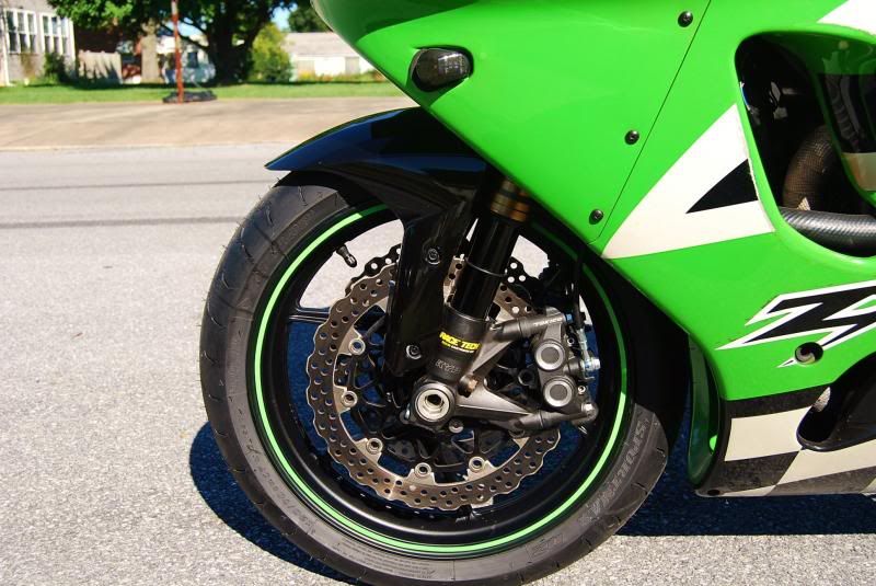

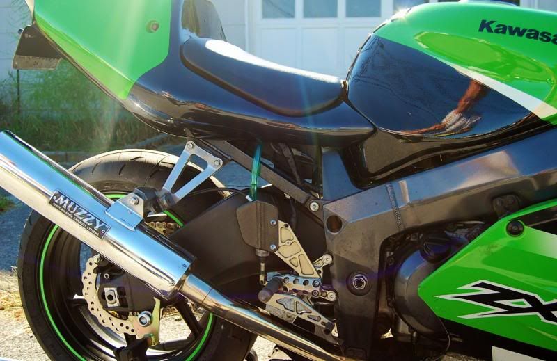

Tied up the loose ends. Set my tire pressure. Took the bike out in front of the garage, put it up on the rear stand, and had my gf take a bunch of photos with her good camera.
Pics in just a bit, gents. :cheers
