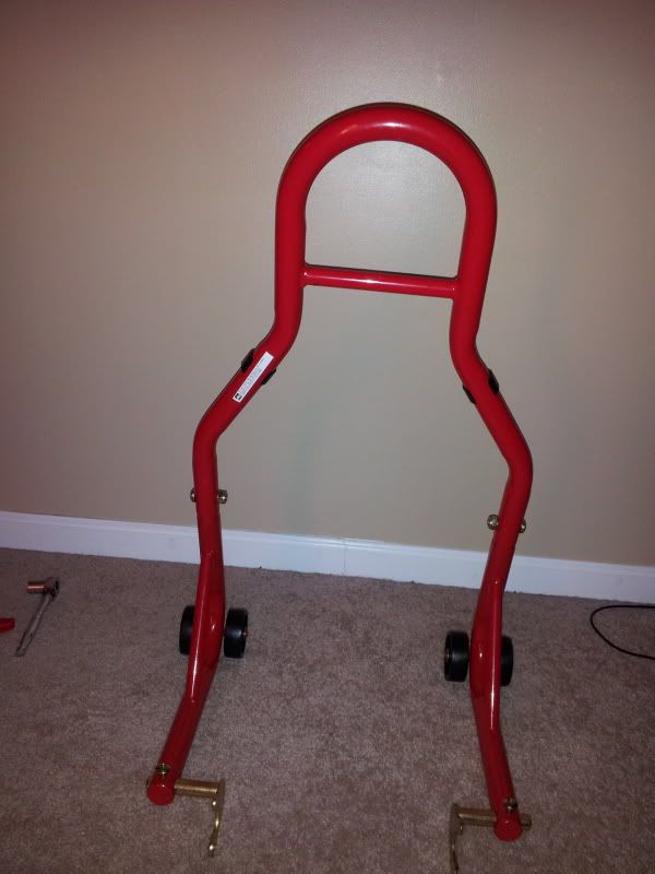

So last night my gf and I started tearing the bike last night and hoping it would get done by summer.
Plans are:
Powdercoat frame swing arm and brackets all gloss black
Paint fairings red
New rear sprocket and chain
New chain guard
New fairing bolt kit
New brake pads and front rotors
Possibly powdercoated calipers
Zx9r front forks with new seals
As for the engine:
Zx9r cams
Headgasket
Timing chain
Valve clearance adjustment
Stage one jet kit
I bought a rear spool stand from eBay for $44 and its sturdy and holding up good. Definitely was scared of the quality but I'm satisfied with the puchase
There might be more but this is the majority of it.
