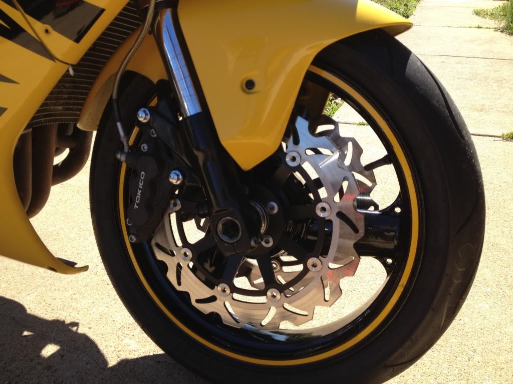

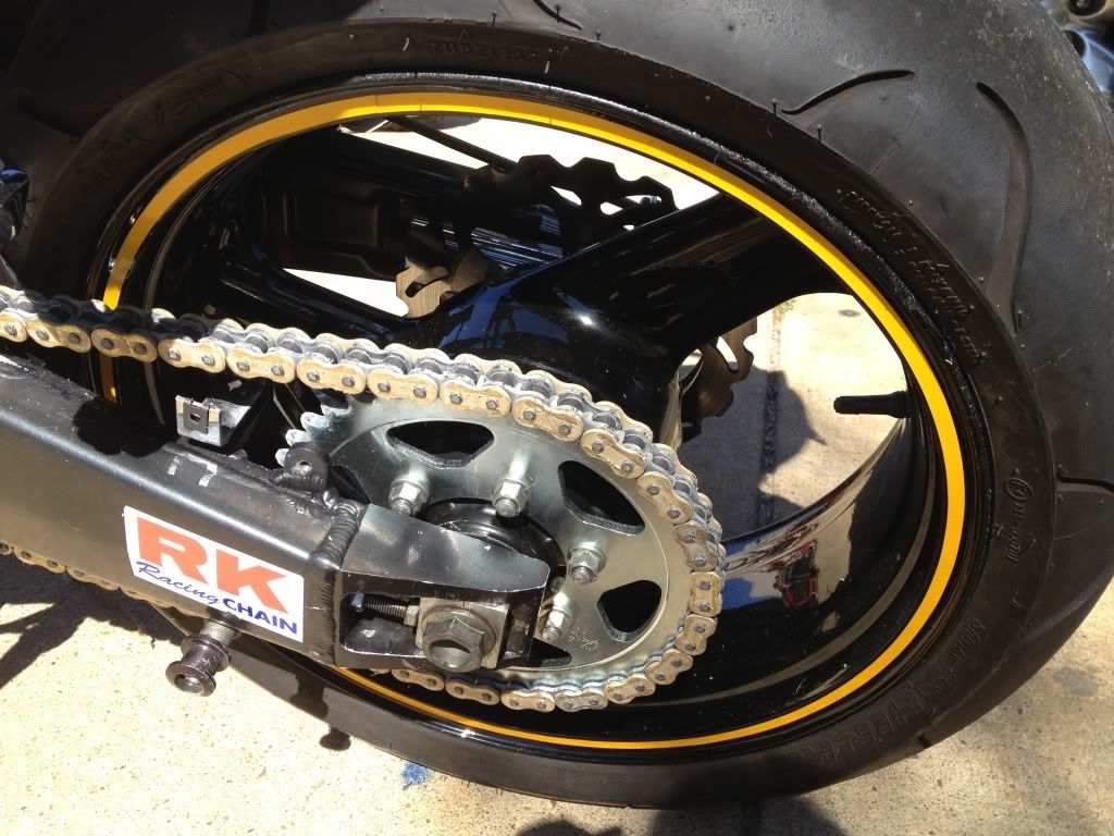

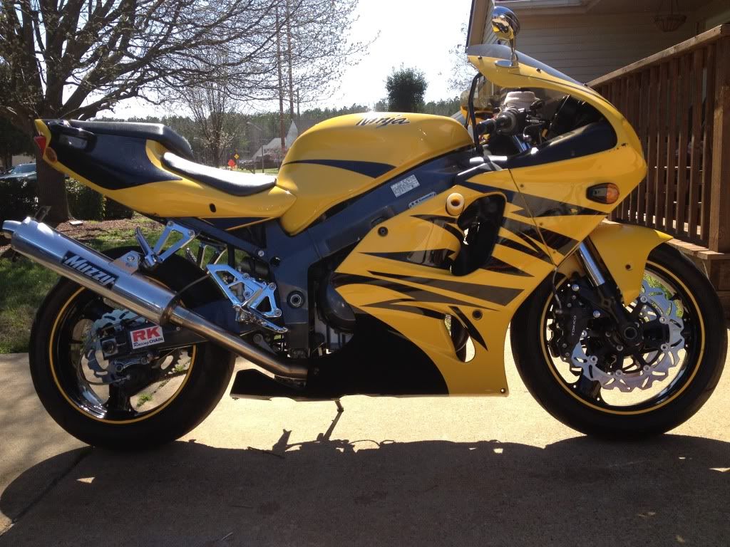

Ok, so I rebuilt the clutch master and slave today. There was a lot of trash hiding behind the slave cylinder, bout a quarter teaspoon of dirt, so it needed to be done but it didn't solve my problem. going to pull the clutch cover off again and measure the friction and separator plates separately and see where the hell i went wrong. Anyways i threw on one of the plastics and took some pics with the new powder coat on the wheels. wish i could have afforded re-chrome but i'm really happy with the new look.
205 Posts
The only reason its so clean is cause i can't ride the damn thing. It just sits in the garage, :nana taunting me :nana

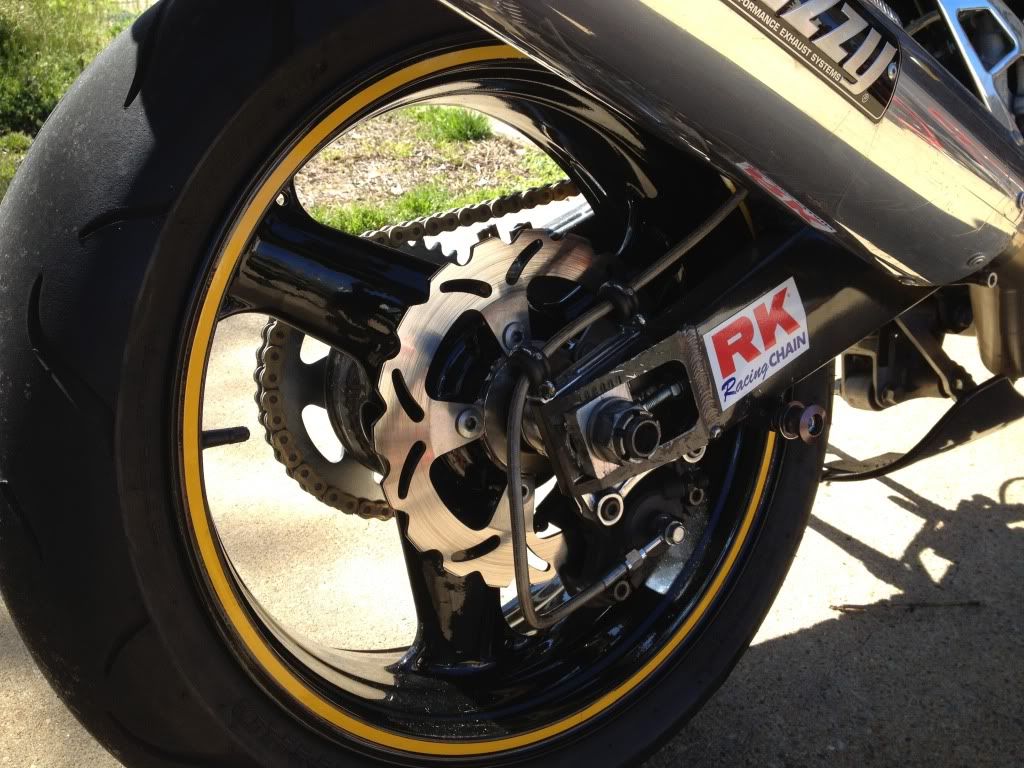

they work great. no chatter, no squeal, not to heavy, and they appear well made for what i paid. $199 plus $50 for shipping for all 3 rotors. the seller was racingboy8261 but i think his price has gone up since last year.
205 Posts
i should mention i spend most of my time commuting so if you plan on track days and such i can't vouch for how they would hold up. but for my purposes they work great.

Looks good!
