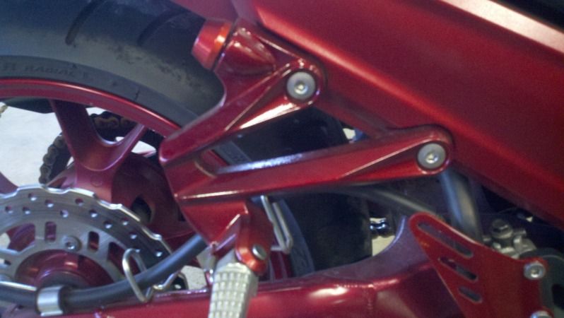

Last month I bought an '08 with 1670 miles. It has a Brock Alienhead on it. Honestly I prefer the look of dual cans, and I like my bikes quiet. I bought some stock exhaust for it, but I'm wondering what are the chances of reprogramming the ecu vs a PCIII? Where does the PCIII plug in?
One other thing, are these peg brackets stock? They don't look like any pictures I have seen.

Looks like the PO chopped off the section where the stock exhaust hanger mounting point is on the stock rear pass pegs.
If you go back to stock exhaust, no need for a reprogram. If the PO just slapped on the Brocks and did not install a PC then your fuel maps are intact.

gpd is correct. The rear bracket has been cut. You won't be able to bolt up the stock exhaust. You will probably have to replace that bracket if you want to install any exhaust on that side.
You probably don't want the stock exhaust either. They're stupid heavy. There are many slip ons available that are quiet.

I wasn't sure if the peg brackets had been cut or not as they don't have saw marks or bare metal showing.
