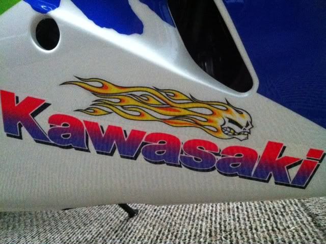

Hi, just picked up a pretty clean 1993 ZX7 to add to the collection. I/m really excited about this bike as I remember looking at them in the showroom the first time around but couldn't afford one at them time.
The question I had was if the graphics on bike are stock. I have looked at tons of pics online of the '93 and the graphics look the same except for mine has a skull / head (flaming?) on it that I have not seen elsewhere. It is also clear coated (?) into the finish like all the other graphics and deff. not just a sticker stuck on. There are 3 of them (2 white and other flame colored) on each side.
Any thoughts or does any other '93's have this????

No those flaming heads aren't stock. Are they cleared?? I wouldn't know without seeing it but unless yge previous owner decided to reclear the bike I doubt it was clear coated.

They are for sure clear coated into the finish. There is no way you could just peel them off like a normal applied sticker. The thing that has me confused is that they appear of similar age to the bike and not something recently added. Also, there is not the normal signs of someone doing mods after factory such as crappy finish or orange peel, etc. Running my finger over the stickers I can't feel any difference between them and the stock graphics!?!?
I was a little thrown off when I went to purchase motorcycle as I would have thought they were something that could be taken back off (trust me, I have pulled many decals, stickers, etc. over them years and am good with the heat gun) and in person couldn't tell if they were factory or not when I realized they were permanent!

I would remove them... sand the clear coat off and remove the stickers carefully!!... then you can re clear with some 2K (2 part) cut in clear coat... wetsand, buff, polish.... then it will look much better...
You could do that in a day easily taking your time... wait 4-5 days for the cut in clear to set and then finish!!
Looks like you got a nice bike there aside from those gross looking skulls!!

Those decals are not stock. Those are old school NO FEAR decals from that era. I know because I used to have some as well that I put on another bike I owned at the time. I agree with ZXgreen7r as I would remove them as well. You have a very nice bike there and Kawasaki got it right the first time with their paint and decals. No need to add to an already perfect scheme.

HaHa ...... thanks Subzero for clearing that up. The thing that was bugging me most (besides the looks) was that I knew I recognized those logos but couldn't place them!!!!! Hell, I probably had the same darn NO FEAR stickers on my jet ski or dirt bike back in the day! Why someone went to that much trouble to clear them in instead of just sticking on I'll never know?
