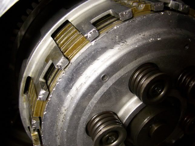

I replaced my clutch yesterday. Here's some pics of what I found when I took the cover off. It has chewed up markings all over the face of the clutch plate. There was no evidence of any trash or debris in there. It was very clean. I wonder what would cause this?

the starter chain tensioner is bad and it will hit the clutch basket and pressure plate.
I've been troubleshooting a noise on my bike. I found my clutch looking just like Lotsokids clutch. Your reply to him was the Starter Chain Tensioner is bad. I was unable to find this. Where is this located? The only Tensioner I found in the service manual was for the camshaft.

tensioner is located under the clutch cover,there is a starter drive chain and the tensioner is under the chain in front of the clutch.
