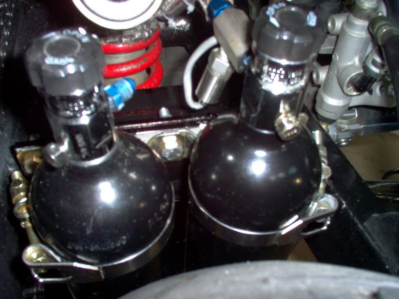

i have a single nozzle dynotune setup on the 12,i have a little .032 jet in there now,that lets me run a pretty clean map,and it hits pretty hard in second gear,may try a .033 (stock gearing) or a .034 with 18-45
i put the yosh system back on the bike,made some changes to the map,a little smoother down low now,not perfect but getting better,i think i need to pull out even more fuel (1500-2000) to get it right
the setup on the busa is a little bit more elaborate,2 nozzles (.025's in there now) btc moto electronics box(set for 2nd gear activation) schnitz 2 dial,set at 50 % and 1.5 sec. build time
both bikes have,co2 shifter,shift light,dynotune digital pressure gauge
at times i have had them tuned up a little harder,.038 in the 12,and .027's in the busa,but that was a bit much for the street
i am allways looking for new ideas,whats your setup ?
