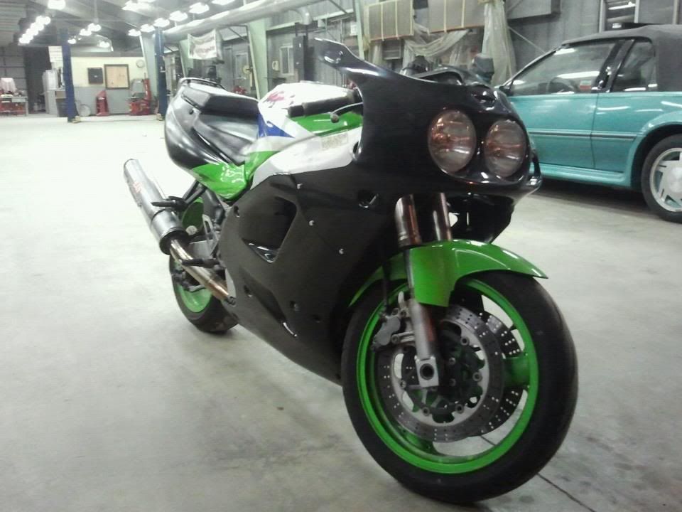

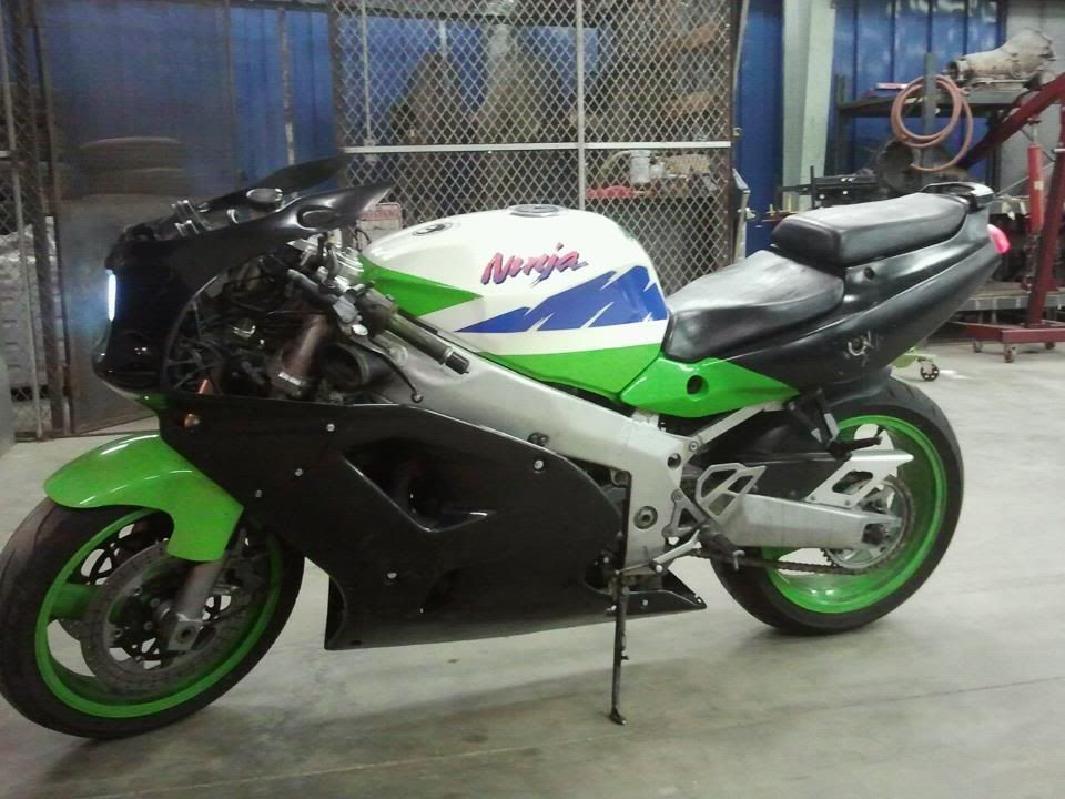

I just picked up this 94 zx7 for 350 dollars. I have owned Yamaha 04 R6 and 03 R6 and a 99R1 that was carb but ran when I got it. The ZX7 has 28xxx miles on it, starts and runs but the idle is up and down I assume carbs need clean as the guy said it sat for 10 months. Came with new front fairings. ( I had to install) love the fairings as you can bend them without breaking are cracking.. I will be searching the forums for carb cleaning on this bike as I never messed with carbs before

$350 with 28,000 miles.Wow,good buy.That 7 looks like a great and solid foundation to start with for a awesome future 7.

That was steal man! If you go to YouTube and search for carb cleaning how to, there's a 3 part series thats very detailed in how to clean them. Just had my carbs cleaned and she purrs like a kitten now.

Fairings looks like Maiers... Good fairings.

Sweet deal! I think you stole it for that price.

Wow! not bad at all.
Josh
They are, he paid 600 dollars as I found the recipe. He was asking 500obo on bike but his wife said 350 now and it’s yours so I loaded it up and was shocked when you gave me the plastic.
