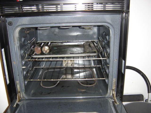

I bought this wall oven for 40 bucks, and it works great for PC. It only has to maintain 400 degrees for 20 minutes. sorry have to fix the picture.

Here's the oven from a second hand junk store.

The 400 degrees for 20 minutes, is what PC needs to cure in the oven.
The reason you cant use it in your kitchen oven is that PC is as fine as baby powder. As it heat up,some of those fine particulates may detach and float around your oven. You dont want to have those particulates attaching to your Meatloaf and then be ingested. You also dont want to apply PC without some type of breathing mask.
On a side note, if you do get an old oven to PC in, dont tell your friends, they'll have all kinds of stuff for you to do.
